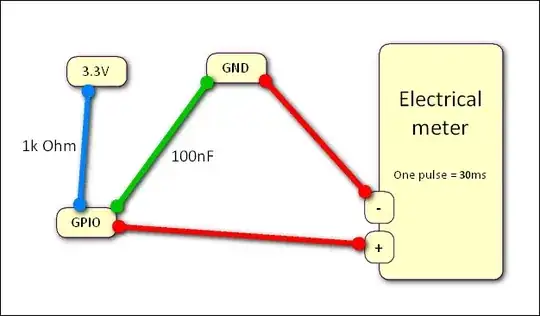

# UPDATE 5, 2014-12-14 20:11 #
Though I have dramatically reduced the weird ghost pulses by replacing the pulse wires with network twisted pair cables, I am not sure I have 100% eliminated them as I suspect there to be minor issues when receiving multiple pulses simultaneous on several GPIO pins. I am considering to try out the hardware debouncing option, which I have not done yet - just to rule out if this can help or not.
Can someone please advice if this drawing below will be perfect for my setup? Is the resistor and capacitor good with a 30ms pulse from the electrical meter or should I instead use a bigger/10uF capacitor (10ms?)? Then of course I should scrap the internal pull-up resistor and the software debouncing.
The full Kamstrup 382L data sheet is here but this is what they write about its "S0 supply":
Sends 24 V via 2-wire and pulses by drawing the voltage to 0 V at every pulse.
This is what I plan to test:
Hardware debouncing
Sorry for reasking this again but I really want to make this as good as possible and not fry my RasPi (I have no clue about hardware);-)

This is not really a Pi question, but an electrical engineering question.
I assume the "electrical meter" is producing contact closures, but this is unclear.
You are working in a noisy environment, so you should use good practice.
  1. Connect to the Pi GND as common NOT the +3.3v rail.
  2. Take measures to reduce interference. E.g. use twisted pair (or shielded cable) - a separate cable for each meter, with the only common connection the GND at the Pi end.
  3. Use low impedance circuitry e.g. a low value pullup e.g. 1kΩ unless there is power limitation.
  4. Adopt bounce suppression. Remember this needs to be BOTH on contact closure AND contact open. This can be done in software and/or with capacitor to slow transitions.
There are other isolation measures, but the above should suffice for most purposes.
EDIT 2. The picture you pasted seems to show a separate cable for each. Using power cable seems overkill, and simple twisted pair would be better. 3. You are using internal pullups i.e. 50-150kΩ. Use 1kΩ to reduce impedance. 4. I don't know the detail of Python bounce suppression, but the device only puts out 35mS pulses. I would use a capacitor from each input to GND. This ensures the contact closure will deliver a sharp pulse but bounce (or contact open) will be slowed down. You can calculate the time constant from R*C. 1kΩ * 100nF gives 100μS. I would use larger capacitors.
The rats nest of wiring is hardly going to be resistant to interference. A Pi with just unterminated wires will trigger interrupts in a normal environment. You need to use better layout.
  • I have updated my problem - does this change anything? So you recommend dropping the 3.3VDC and instead use a GND? Will I then need a 1K ohm resistor to 3.3VDC as a pull-up? – Beauvais Dec 09 '14 at 12:04
  • I can't claim that using GND as common will solve all your problems, but many people assume that you need +3.3V. This is bad practice (not least because of the risk of shorting +3.3V), but increases the possibility of interference. I would have used 1kΩ to +3.3V. I was going to suggest @joan piscope, but with the low number of pulses you could just log the actual times. If these are clustered it will suggest bounce, otherwise interference is likely. The electrical meterbox is a hostile environment. – Milliways Dec 09 '14 at 22:34
  • It's a little too soon to say this has been solved but I have now changed it to GND instead of 3.3V and it seems to have improved a lot on the ghosting though it has not completely been removed. Do you mind elaborating on point 2+3+4 in your answer? How can I do this? – Beauvais Dec 10 '14 at 19:13
  • Please see my last update as I think you are the one closest to fix my problem :-) Just to fully understand you - do you recommend I use a 1kΩ resistor between 3.3V and each GPIO plus a 100nF capacitor between GND and each GPIO? I will also change the pulse power cables with smaller cables (I have some network twisted pair cable I can use). – Beauvais Dec 12 '14 at 14:10
  • Yes. This looks like the right approach. – Milliways Dec 12 '14 at 22:22
  • It seems the change from pulse power cables to network twisted pair cables has stabilized my pulses and I now trust them - at least enough to use it to count my daily power consumption. I did not test the usage of the capacitor nor the resistor (instead of the built-in) but I don't think it will change the current stability dramatically – Beauvais Dec 14 '14 at 14:11
  • I have just updated with hopefully my last update (update #5) ;-) – Beauvais Dec 14 '14 at 21:32
