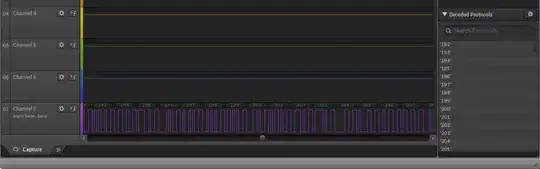

I have experimented and have a sort of solution to sending 9-bit data at 1.25 Mbps.
It involves modifications to my pigpio library.
I've added a gpioWaveAddSerialX() function which extends the gpioWaveAddSerial() function to allow for setting the number of data bits. This function constructs a waveform representing the serial data to be transmitted.
This also required an update to the internal waveBitDelay() function to allow for a variable number of data bits.
The other needed change was to change the base clock from 1 MHz to 1.25 MHz by changing clkDivI = 50 * micros to clkDivI = 40 * micros in the internal initClock() function.
The manifest constant PI_WAVE_MAX_BAUD in pigpio.h was changed to 1000000.
9-bit data 1.25 Mbps overview 9-bit data 1.25 Mbps detail

Test program.
#include <stdio.h>
#include <stdint.h>
#include <pigpio.h>
#define GPIO 14
int main(int argc, char *argv[])
   uint16_t buf[1024];
   int i, wid;
   if (gpioInitialise() < 0) return 1;
   gpioSetMode(GPIO, PI_OUTPUT);
   for (i=0; i<600; i++) buf[i] = i;
   gpioWaveAddSerialX(GPIO, 1000000, 9, 2, 0, 1200, (char*)buf);
   wid = gpioWaveCreate();
   if (wid >= 0)
      printf("ready recorder, then return\n");
      getchar();
      if (wid >= 0) gpioWaveTxSend(wid, 0);
      printf("stop recorder, then return\n");
      getchar();
   else printf("error %d\n", wid);
   gpioTerminate();

  • There is some very interesting stuff here; I thought I would share my findings as I followed the post using the test program above but was not getting any output. For me 'wid' was being assigned a value of 0 which meant the 'gpioWaveTxSend(wid, 0)' command was never being executed. I removed the 'if (wid)' and was able to see the output which looked to be 1.25Mbaud. Great work joan and thanks for all the help. –  Feb 11 '15 at 15:21
  • @SerialMadMan Indeed, my mistake. I'll update the test program in the post. A legal wid is >= 0. – joan Feb 11 '15 at 19:48
  • Thanks a lot Joan. I've seen the pi outputting at 1.25 MBaud measured with a lecroy waverunner. Just to work on the application layer for a bit. Thanks again! – SerialMadMan Feb 23 '15 at 16:06
