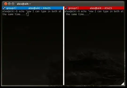

You could also use a terminal emulator that supports groups, such as terminator terminator groups
