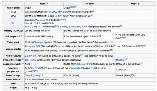

Raspberry Pi does not meet those requirements, due to the fact that the maximum Raspberry Pi specifications are (from Wikipedia):
So, to answer your question: no, you can't.

1You seem to have pasted the requirements twice. Also, I seem to remember running Windows XP in 8-bit VGA mode, like 320x240x8, so it at least does support such resolutions. Maybe plain VGA card would be enough. – Ruslan Aug 30 '14 at 20:42
3STOP UPVOTING THIS! This is only slightly nearer the answer than the one on the Potato SE website, someone asked if their potato could run windows XP and (I think it was the same guy) posted the XP minimum specifications and said "Even the most advanced potato doesn't match these" - It cannot run, it's not because it's a bad computer, it's because it's an ARM CHIP! – Alec Teal Aug 31 '14 at 00:26
@AlecTeal Not necessarily. If it had a better processor, it wouldn't work either. – Aug 31 '14 at 09:24
2Yeah, this answer is puzzling to me too. The OP says that the rPi doesn't have enough requirements, lists XP requirements then lists the Pi's. The XP requirements are much lower than what the Pi has.
The only thing questionable is possibly the video/sound support. Not that it would be worth it, but it might be entirely possible to run a VM XP on Pi. Don't know if it would be worth it or even feasible but don't care.
I'm just pointing out the obvious flaw in this answer. And asking the not-so-obvious question, why doesn't it meet the requirements?
– Levi Roberts Dec 09 '14 at 15:59 -
1P.S. I've seen Mac OSX Mavericks run on an ARM device using QEMU. So, again.. not sure why the rPi can't VM XP. – Levi Roberts Dec 09 '14 at 16:01
12This answer is just wrong. The reason you cannot run Windows XP on the pi is because Windows XP has not been compiled for the particular architecture. If it were, it could be used. But since the source code is not available, no one can legally do it. – goldilocks Dec 09 '14 at 16:33
