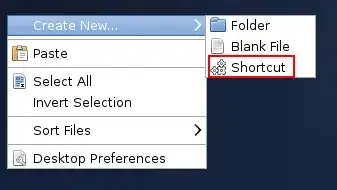

Just right-click on your desktop and select Create New Shortcut from the popup menu:
create new shortcut
Then, you can input the name of the shortcut you want, the command, and the tooltip, as well as change the logo (not to mention more advanced features.) You'd probably want to check the Runs in Terminal Emulator option:
lxshortcut
In your case you would want it to look somewhat like this:
check the temperature - lxshortcut
Hope this helps you! If having the command as simply temp doesn't work, comment back here and I'll see if I can't figure out why!
