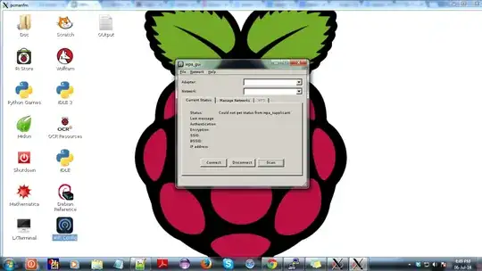

And Also I tried Like this Post wifi setup for multiple networks 2nd answer i.e USER ppumkin's answer
It is showing the Wi-fi Connection when I
sudo wicd-curses
Even I Configured the Same Way, but When I click "C" it is disconnecting From LAN As Specified By [USER]ppumkin, but It is not Connecting to Wi-Fi. enter image description here
I am Checking it with a webserver.. I've Installed Apache In Pi. Using Wired Network I will Get Index.Html but with Wi-Fi I am Not Getting the Index Page
