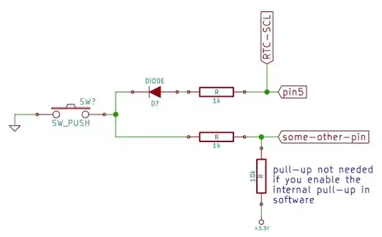

The RTC uses pin 5 as an output, for the SCL signal. But you want to use it as an input. This could be difficult, and could even damage the Pi (if SCL is 3.3V and you press the button you'll be creating a short, possibly damaging pin 5 and maybe even the entire chip).
To prevent any damage you could add a resistor between pin 5 and the button.
Reading pin 5 while it is an output isn't possible, but you can just connect a second (free) pin the the button, and read that one. See schematic below
This doesn't work
The top resistor should be less than 116Ohms to make GPIO 5 get below 0.8V. This is because of the relatively low value (1.8K) pull-up resistor present on the board, and the voltage drop of the diode. However when pin 5 is an output, and high, 28mA will flow when the button is pressed. Which is more than the Pi can handle.
To prevent a LOW on output-pin 5 from registering as a button press you need an additional diode.
Not ideal, but it will make you use a single button for both wake-from-halt and shutdown. Also note that it will disrupt I2C communication if you press the button while the PI is talking to the RTC module. Though the chances of that happening are slim, as communication is maybe once every few minutes, and only takes a few milli-seconds.
Gerben
  • 2,420
  • You can read gpios which are set as outputs. The current level is returned (which may not be the commanded level). – joan Jun 25 '14 at 20:05
    Thanks. That's what I wanted to know. For now I will not follow this thought though. After a deeper thought I don't see any advantage to my project. Btw which programm did you use for creating the diagram. – Christoph Daum Jun 25 '14 at 21:06
  • @Gerben I don't see what the circuit above is supposed to achieve. Pressing the button will pull pin5 to ~1.7V, which even if configured as an input will not be reliably detected as low. As another pin is being used to detect button push it also seems to achieve nothing. – Milliways Jun 26 '14 at 01:20
  • I forgot about the 1.8k pull-up. The 1k resistor should indeed be a bit lower to work properly. What the circuit does? when the pi is shut down, pulling pin 5 low will make it boot up again. – Gerben Jun 26 '14 at 07:44
  • Circuit was created in KiCad. Free and open source software. – Gerben Jun 26 '14 at 07:45
