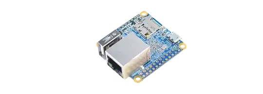

The answer really depends on what you call "similar". If you're interested in boards capable or running Linux, Armbian download page provides a nice list of boards running Debian/Ubuntu, sorted by SoC name and manufacturer. They have great detailed photos of supported boards there. Here's one of the smallest for example:
