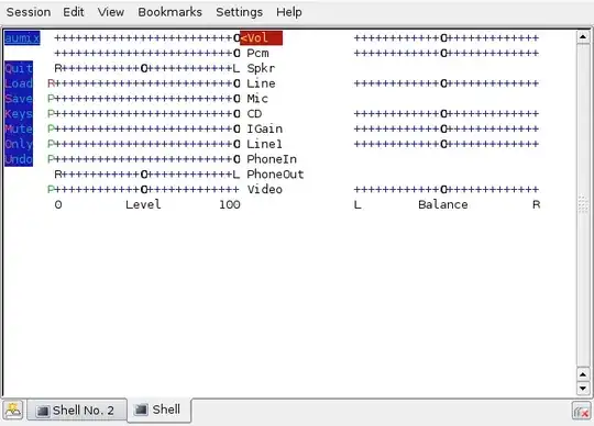

According to this page there is a "sound mixer application in your applications menu", though I haven't found too many references to this, so I think what I'm about to say will be as good an alternative.
There is a very useful aumix tool which provides a visual terminal view (see image), though it won't be what kids are used with standard PCs!
There's some info on it here, here is the author's site, and there is always about.com

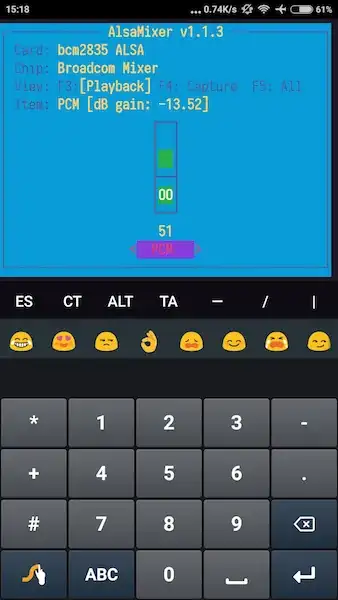

alsamixer comes out-of-the-box and has a text-mode "GUI" which works over ssh.
You can use up/down arrows to control volume, as well as numbers from 0 to 10, which means you can turn your mobile into a fancy "remote volume control", where tapping 1 would be the lowest volume, and 9 the highest.
control raspberrypi volume from mobile phone
Number keypad mode is available (on android) in gboard, swype, swiftkey, etc. Also many keyboards/roms have the option to show arrow keys.
Use any ssh client of your choice, eg, termux, juicessh (android), or termius (ios/android).
Moreover, if you use termux with the termux-widget (€2.09 on google play, or free if you install via f-droid, since the app is open-source), then you can launch alsamixer by tapping in the desktop widget.
To make the shortcut appear in the widget, create an executable bash script under ~/.shortcuts/pi-volume.sh with the following content:
# use your pi's IP or the alias configured in ~/.ssh/config
ssh -t pi@192.168.0.123 alsamixer
The -t switch is important here as it allocates a TTY.
Now you don't need to type anything in the terminal on your mobile, just tap the script name in the widget.
(I have no affiliation with termux; I am just a user of the app.)
