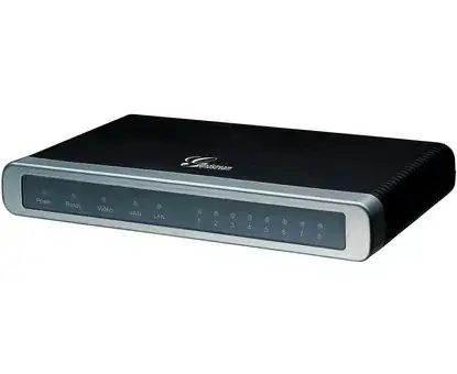

Assuming you can get Asterisk rolling, I'd probably go for one of the ethernet connected FXO boxes. Many companies make them. Here's an example:
Official Grandstream web site with details

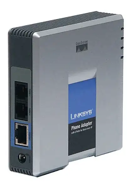

Linksys PAP2
A really really cheap solution to enable your existing home phones to use VoiP instead- If you want to recieve phone calls on your existing number, you can buy a cheap DID for voip and then redirect all incoming land line calls to your VoIP DID. Sorted

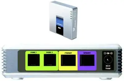

Linksys SPA2102
This is a step higher and can act as a repalcement router but does not have to. It jsut has the facility. This model allows you to use 2 VoiP lines/channels and connect 2 phones or 1 phone and 1 fax or 2FAX's. What ever you fancy. Again you can redirect your land line to your Voip DID
