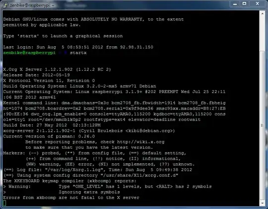

Screenshot of what happens with Xming running, and I SSH in and call startx:
SSH with Xming response

This answer says startx is unnecessary, because it starts the RasPi X server, and I am using the Xming server on Windows. In that case, how do I get to the desktop/GUI on Xming from Windows? Because, even with Xming running, and SSH enabled, I don't get anything but a normal console prompt. Maybe I'm doing it wrong. What I want is my full, normal RasPi GUI running in a window on my remote Windows PC. I do not want to use VNC. I am forwarding over the Internet. How do I get there?

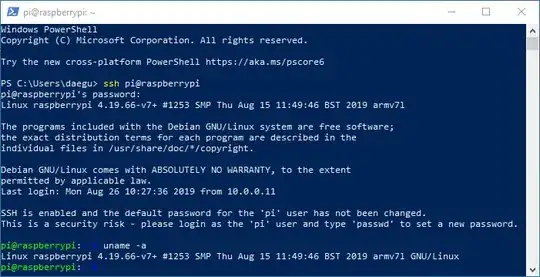

Try to establish a regular SSH connection from Windows to the Raspberry Pi using PowerShell:
Log in to Raspberry Pi on Windows with PowerShell and SSH
Given that Raspbian Buster includes X11Forwarding yes in /etc/ssh/sshd_config, your Raspberry Pi should also be able to forward the visual output of X11 applications to an X server on Windows.

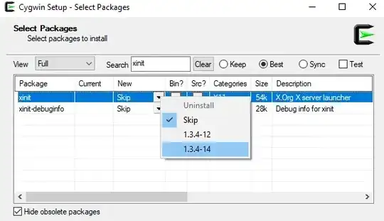

  4. Set "View" to "Full" and search for xinit.
  5. In the "New" column, use the drop-down menu to change the value from "Skip" to xinit's latest version:
Install package xinit with Cygwin

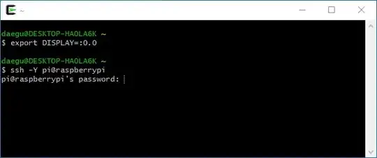

  2. Set the DISPLAY environment variable to where the X server on Windows runs:
    export DISPLAY=:0.0
  3. Connect to your Raspberry Pi with X11 forwarding:
    ssh -Y pi@raspberrypi

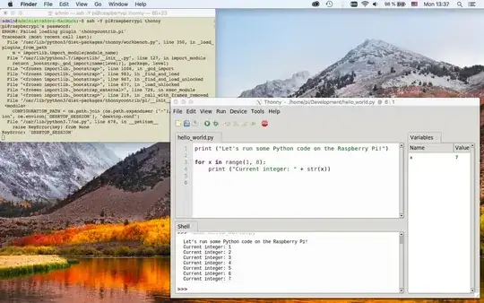

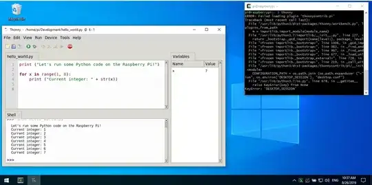

Inside the SSH session, you can now start an X application on the Raspberry Pi like Thonny:
Thonny forwarded to Windows

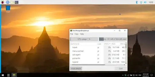

Alternatively, as user1297 mentioned in the question's comments, you can run x-session-manager to emulate the experience you'd get when connecting to the Raspberry Pi via HDMI on an external monitor:
Rasbpian desktop forwared to Windows

XQuartz provides an X server for macOS.
Install XQuartz, log out and back in (to make the new value of DISPLAY effective), then launch applications with SSH from Bash:
ssh -Y pi@raspberrypi thonny
Thonny inside macOS using XQuartz
