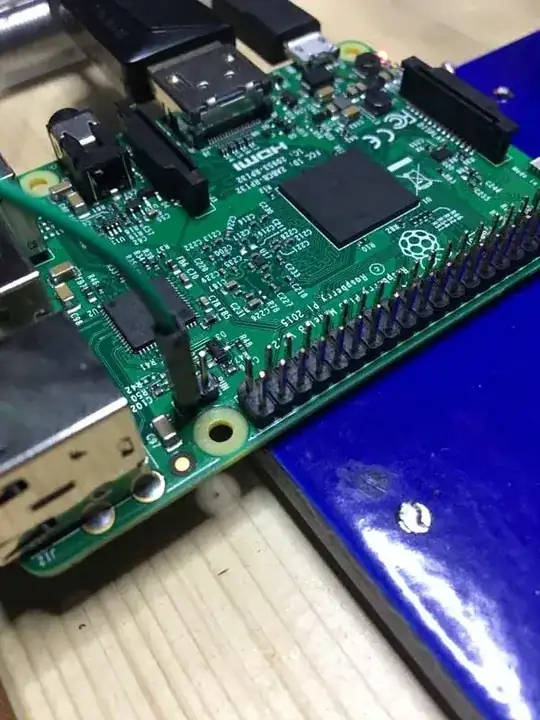

It is very easy to wire a hardware reset to the Rpi3.
Here is where you will find holes already open and waiting:
(Shown here with header pins soldered in place directly above the screw hole)
Don't use too much heat or solder. A little bit will do.
It is delicate underneath, with a thin trace.
I leave them just open, and use the green wire to briefly short them together.
Alternatively, connect to a momentary-on (NO) pushbutton.
