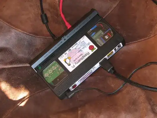

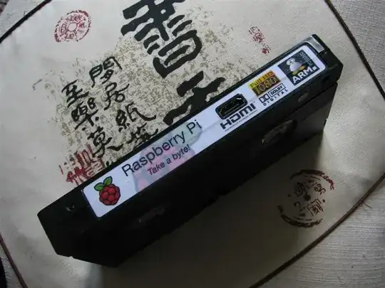

VHS-Pi (Credit to Maarten) as a case - built as a portable media server (when visiting friends)
Includes:
-RaspPi (duh) fully un-modified with the following directly connected
--Ethernet 'break-out' cable
--Audio 'break-out' cable (not fully completed yet)
--5v Supplied over GPIO
-7-Port D-link Hub (4 ports exposed, 3 for internal use)
--Wifi dongle
--Bluetooth dongle
--USB thumbdrive for added storage (not pictured)
Plugged in enter image description here

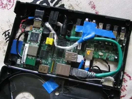

Inside the VHS Tape Case

  • you win, the box wouldn't do for someone as destructive as I. I have no vhs tapes though... I can't believe it's thin enough for that. – Magpie Aug 02 '12 at 13:49
  • Added photo on inside the VHS case - contains the pi and 7 port hub - would like to create my own version of this. – Mapperz Aug 02 '12 at 13:58
  • Dude, the only thing you are missing are some RGB leds that illuminate the box in a wicked way. That is the best mod I have seen for 2012! Now where did I put my VHS cassettes... PS Can we have the source for sticker please ? :-) – Piotr Kula Aug 02 '12 at 14:35
  • Please contact Maarten via the RPi forum for requests http://www.raspberrypi.org/phpBB3/viewtopic.php?t=12925&p=136708 – Mapperz Aug 02 '12 at 15:07

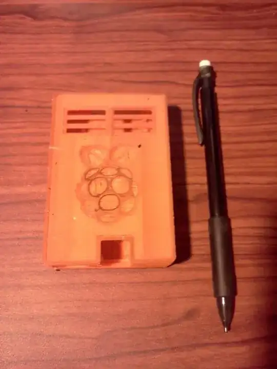

I have a 3D printed case. If you know anyone with access to a 3D printer, there are a variety of case designs freely available on thingiverse.
3D printed case
