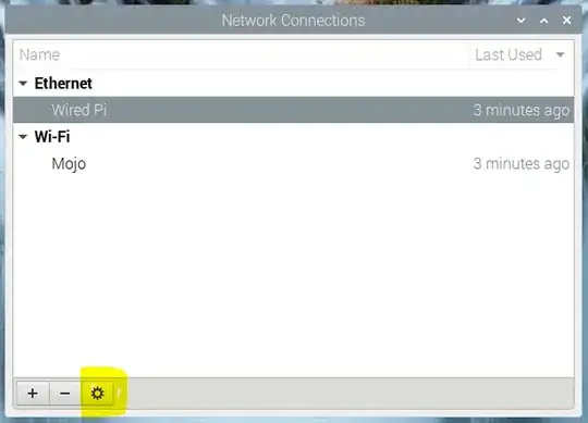

Now connect to a wifi network using the new network manager you will find the the icon
on the task bar.
Edit the settings menu to configure to your needs. The image is from selecting the mode pull-down list.
I've done this on a Pi Zero W with an external USB-Ethernet port to share the WiFi connection with a Ethernet only device. I've also tried this on a Pi 4 so it should work for you.
