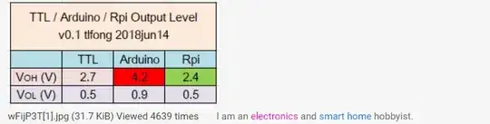

To understand why all (well, almost) newbies get confused, we need to look closely the following logical level chart, showing the root cause of newbie 3V/5V sorrows.
logical chart
Let us focus on the left most two columns, TTL and Arduino. In those were the days, my Arduino friends thought the imperial Arudino empire would live happily ever after, never imagined that some big guys like Rpi would soon appear. So the story goes than the Arduino engineers devised a new logical level standard/specification:
(Arduino) High level means at least 4.2V
Low level means at most 0.8V
The result is that most devices, say actuators, including relays, solenoids, buzzers, you name it, meet this spec, with (the latter Rpi guys scary) requirement that to do something using High level, you need to give 4.2V or higher (But how can 3V3 Rpi do that!).
Of course this makes the life of Rpi, born later, very miserable, because they are weak 3V3 guys, and their High level is usually 2.4V to at most 3.2V.
This is what I usually refer as
The (Arduino compatible only) Low Trig Relay is always on, because Rpi's High is Not High Enough Problem.
Of course there are solutions and workarounds. You can search for a couple of my suggestions in this Rpi SS and EE SE forums. EG. Appendix C of this Q&A (1) How to properly use a relay module with JD-VCC from Arduino/Raspberry? EESE, Asked 10 months ago Active 3 months ago Viewed 7k times.
You can use a Logic Level Converter Bi-Directional too, if you want.
