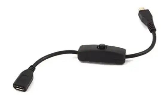

You can buy these USB power switches for Rpi 1 to 3 and a USB-C type for Rpi4. I have one on each of my Pis. Around 3 to 5 UK pounds or equivalent. They often have an LED to show when power is on.
