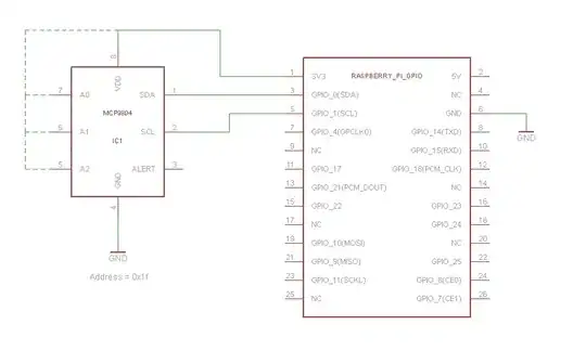

Here's how to connect a MCP9804.
You can use it like this:
root@raspberrypi:~# modprobe i2c-dev
root@raspberrypi:~# modprobe i2c-bcm2708
root@raspberrypi:~# i2cdetect -y 0
     0  1  2  3  4  5  6  7  8  9  a  b  c  d  e  f
00:          -- -- -- -- -- -- -- -- -- -- -- -- --
10: -- -- -- -- -- -- -- -- -- -- -- -- -- -- -- 1f
20: -- -- -- -- -- -- -- -- -- -- -- -- -- -- -- --
30: -- -- -- -- -- -- -- -- -- -- -- -- -- -- -- --
40: -- -- -- -- -- -- -- -- -- -- -- -- -- -- -- --
50: -- -- -- -- -- -- -- -- -- -- -- -- -- -- -- --
60: -- -- -- -- -- -- -- -- -- -- -- -- -- -- -- --
70: -- -- -- -- -- -- -- --
root@raspberrypi:~# i2cget -y 0 0x1f 0x5 w
0x67c1
Converting 0x67c1 to a temperature is a little convoluted. The MSB is 0xc1 and the LSB is 0x67
The first 4 bits of the MSB are dropped and which leaves the temperature in 16ths of a degree
(0xc1&0xf)*16+0x67/16.0 = 22.4375 degrees
Python Example
In addition to loading the i2c modules above, you'll need to install the python-smbus package. You can reduce self-heating by shutting down the MCP9804 between readings.

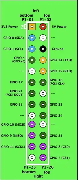

  • P1 (LEFT BOTTOM) - 3.3V
  • P6 - GND
  • P8 GPIO14 - TX
  • P10 GPIO15 - RX
Important: Remember the RPi UART runs at TTL 3.3V - Be careful not to use High Voltage 5v/12volt Uart direct to the RPi. It will cause damage!

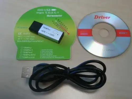

A simple, cheap USB "HID TEMPer" thermometer also works, and is much easier to connect for those who are yet to fiddle with UARTs or GPIO, like me.
HID TEMPer USB thermometer
My RPi provides enough power to drive it directly from the USB port without a hub.
To set this up with Raspbian Wheezy, I followed these instructions which were written for Ubuntu (disclaimer: link is for a post on my own blog). For the Raspberry Pi, I only had to make one small tweak to set LIBUSB_LIBDIR when installing the Device::USB perl module so it could find libusb in the non-standard arm location. The complete instructions follow.
To get a simple reading without any of the munin stuff, install the dependencies as follows (as root):
apt-get install libusb-dev
export LIBUSB_LIBDIR=/usr/lib/arm-linux-gnueabihf
cpan Inline::MakeMaker
cpan Device::USB::PCSensor::HidTEMPer
Create readtemp.pl:
#!/usr/bin/perl
use strict;
use Device::USB::PCSensor::HidTEMPer;
my $pcsensor = Device::USB::PCSensor::HidTEMPer->new();
my @devices = $pcsensor->list_devices();
foreach my $device (@devices) {
    print $device->internal()->celsius()."\n" if defined $device->internal();
And run that as root to see the output. In my case, it's a little chilly in the garage this evening:
day@pi:~$ sudo ./readtemp.pl
16.5

Connect the white wire to GPIO4, The red wire to 3V3, and the black to GND. You also connect a 4.7K resistor between the white and red wires.
