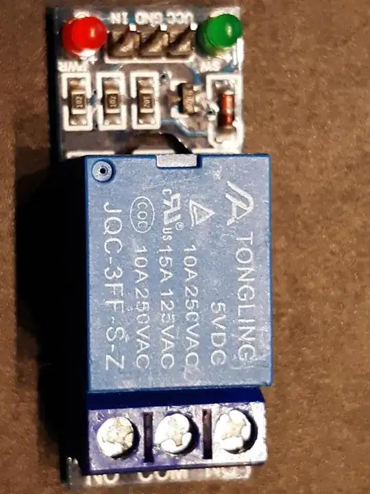

I need to drive three relays and because I already destroyed a RPi by using too much power I was thinking to power the relay-modules by an external 5v psu Psu (Vcc), RPi and relay's ground pins all connected together. The Relay's IN-pin is directly connected to different GPIO pins (cf. image). This should be possible according one of the answers above.
Now I see the relay is always on (green led is always burning) even if I toggle the GPIO value Low <-> High. However, I see some difference in current consumption
- If the GPIO value is low, only 136uA is consumed.
- If the GPIO value is high, 4mA is consumed (I think this is safe, just below 5mA).
But, again, in both cases the relay stays ON and is not toggling when I expected it.
Can someone give me some advice/tips to 'debug' this problem? Many Thanks.

Edit - V3
@joan,
as asked I added some pictures of the module. Hopefully you can help me out with this. Thanks already.
