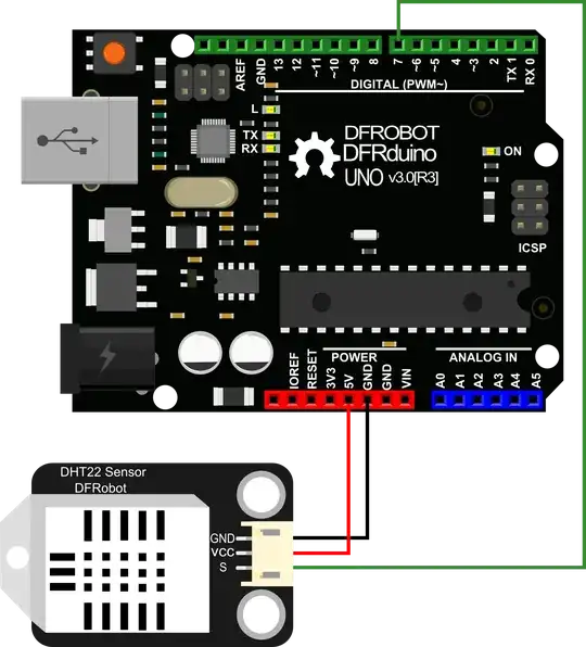

I think (unless you have not corrected it yet) you have your wires wrong. The green one is the signal (data) and you have it connected to the 3V3.
Example how to connect to DFRduino
Source: DFRobot - SEN0137 DHT22 Temperature and humidity module
Hint: Try running it in the loop like in the dht_simpletest.py - as @Milliways mentioned the python library is not stable.
Running in the loop and printing exceptions will give you more debug info - for my Pi Zero v1.3 this message was printed among others - misreported, see: issue-33.
