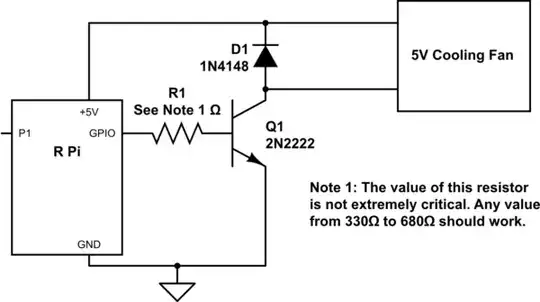

Hardware
The hardware requirement is simple enough: a 2N2222 transistor serves as a switch to turn the cooling fan on & off. The 2N2222 is driven from a GPIO pin. A ~500 resistor to bias the transistor properly, and a small diode for back emf protection completes the circuit.
The author has created a YouTube video illustrating the hardware construction. IMHO, this is more elaborate than necessary, but here's a schematic showing the essentials:
