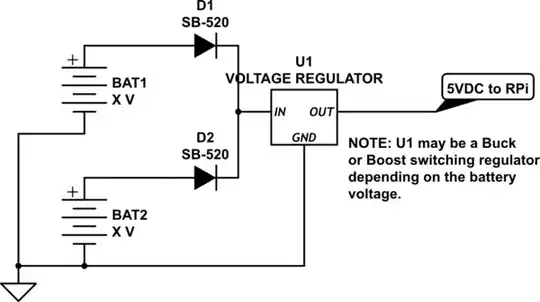

Here's one way to do it: combine two (or more) batteries in a "wired-OR" configuration. This is fairly generic as you provided no details on your battery voltages. If you want to edit your question to add those details, we'll try to be more specific.
schematic
