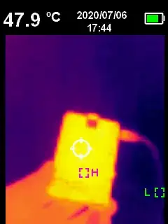

However it is pretty hot. I can barely hold my finger on SoC and network chips. My thermal imager shows this:
(Note that the dark squares on the top image are reflective surfaces - which always looks dark on thermal images)
Highest temperature is 51°C with ambient 28°C.
