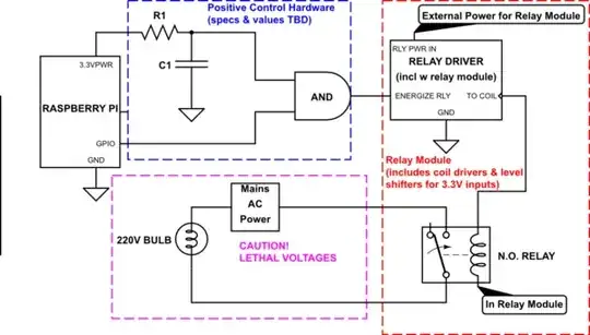

NOTE: Please know this answer disregards all comments made to the OP's question.
The issue you're facing cannot be solved with software alone. You will need to add some hardware if you wish to maintain positive control of your relay at all times. As made clear in @Milliway's answer, GPIO states are indeterminate when power is removed from the RPi - that is to say when power is removed from the RPi, the state (HIGH/LOW/OFF) of the GPIO pins is unknown/undefined. It follows then that you cannot maintain positive control of your relay if you allow GPIO pins with undefined states to control it. Once you understand that, you are on your way to a workable solution.
Based on your "Expected scenario", there is a fairly simple hardware solution outlined in the schematic below. Simply described:
  • When the RPi is not powered up, this hardware will force the relay in the schematic to be in its de-energized state.
  • When the RPi is powered up, the GPIO pin will take over control of the relay's state.
In hardware-logic-speak this is known simply as a AND gate - its "logic equation" in this example is as follows:
IF (RPi IS POWERED) AND (GPIO IS HIGH) THEN (RELAY IS ENERGIZED)
Or, re-phrased to mimic a software idiom:
ELSE (RELAY IS NOT ENERGIZED)
Notes re Schematic:
  1. Due to the absence of any hardware specifications in the original question, the schematic shown here omits certain details required for implementation. If you need implementation details, please edit your question to include specifications for your relay (or a link to its spec sheet).
  2. R1 & C1 work to perform a power-on-initialization of one of the inputs to the AND gate. When power is applied to the RPi, the voltage across C1 will increase from 0 (GND potential) to 3.3V at a rate determined by the R-C time constant (tc = R1 * C1), eventually reaching the supply voltage (3.3V in this case).
    Consequently, choosing the values of R1 and C1 allow you to determine how long the output of the AND gate is forced low - and thereby inhibiting the GPIO output from controlling the realy.
  3. Also know that for situations requiring a very long initialization time, there are alternative methods and designs to accomplish this. Likewise, other features such as fail-safes, hardware interlocks, etc. may be accommodated.
  4. The warning we give to everyone who dabbles in circuits containing potentially lethal voltages applies for this project. A careless moment can change your life - so incorporate safeguards in your work habits, and please be careful.
schematic
EDIT: Additional details re. OP's edited question:
The relay vendor (eBay) did not provide a spec sheet. However the eBay seller's page has information that allows the design to be furthered.
Unfortunately, the eBay seller's information does not include some vital information:
  1. the supply current requirements to power the relay module.
  2. the relay configuration (i.e. SPDT, SPST, DPDT, etc)
We'll assume that the RPi's onboard 5V regulator will source enough current to power the relay module: REF1, REF2. We'll rely on this answer for the relay configuration.
OPINION: One should not have to rely upon these assumptions, especially given that this relay is being used to handle potentially lethal voltages. I agree with @TomCarpenter's comment: "The most important rule to follow is no datasheet = no sale"
All of that said - and assuming all assumptions hold up - the following schematic is capable of compensating for the indeterminate state of the GPIO pin during startup and power down. Here's a summary of its operation:
  1. When the RPi is powered down, its +5V supply will go to zero. As we are powering the relay module from the RPi's +5V supply, this will remove power from the relay module. When power is removed from the relay module, the relay contacts will be in their "de-energized" (aka "Normal") position.
  2. When the RPi is powered down, the voltage across C1 will begin to drop as it discharges through the resistor R1. This will take one of the inputs to the AND gate low, thereby making its output - and the relay's control input- zero/LOW. And so, even if the relay is powered from a source other than the RPi, this will cause the relay contacts to move to the "de-energized" position.
  3. When the RPi is powered up, the voltage across C1 will be zero, forcing the output of the AND gate - and the relay control input - to also be zero.
schematic
simulate this circuit
IN CLOSING:
One final caution in addition to all other warning here about lethal voltages: Before applying mains power (220VAC), test this circuit with safe voltages.
