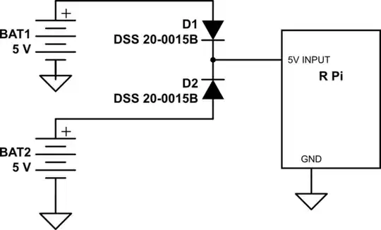

Putting two caps that are rated at 2.5V in series is NOT going to give you an equivalent 5V rated cap. You shouldn't do that. And think through the physics of holding up a (let's say) 5 Watt load with capacitors while you move wires around. There are better ways to do this:
Perhaps the simplest way to do what it sounds like you want to do is as follows:
schematic
The diodes form a "wired-OR" power source that isolates one battery from the other. In this way, both batteries may be connected at the same time - effectively giving you a "make before break" power switch. The diodes are Schottky diodes chosen because they have a lower forward voltage drop than a p-n junction diode. In fact, you could extend this scheme to 3 or 4 or more batteries. This particular part (DSS 20-0015B) appears to have good availability & reasonable price.
One potential issue with this scheme is the batteries themselves, and the RPi's rather tight tolerances for input voltage. If these figures are still correct (4.75V - 5.25V), your batteries will need to be almost "spot on" to get reliable operation. If your application is "critical", all is not lost as we can still use the "wired-OR" scheme above with a slight twist:

    I like your idea, but the statement that two 2.5V caps in series don't give you a 5V cap is not true. In fact, that's exactly how higher-voltage supercaps (or Li-ion batteries with more than 4V) are made. – Dmitry Grigoryev Apr 22 '20 at 07:58
  • @DmitryGrigoryev: I said a 5V rated cap. The max voltage rating has nothing to do w/ the voltage impressed on a cap in a circuit application. Also, I didn't mean to imply that the voltage impressed across capacitors in series couldn't be managed by clever design - as you have shown in your answer. [continued-] – Seamus Apr 22 '20 at 12:05
  • But if the caps are strung in series across a load - as the OP I think intended in his question - it's demonstrably true the voltage impressed across a cap is a function of the charge stored in it, and the Kirchoff equation for that particular arrangement. Surely you agree with this - that belief is reflected in the design you've presented in your answer! You know as well as I that you cannot put a 5V-rated cap in series with a 10V-rated cap, and have an effective max voltage rating of 15V. Sorry that wasn't clear in my writing - I'll try to fix it. – Seamus Apr 22 '20 at 12:07
