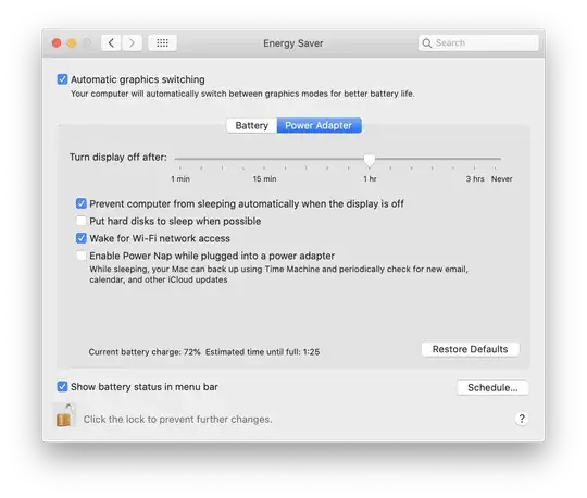

But those of you familiar with Apple's myriad schemes for power saving may suspect that is the most likely cause. I thought so too initially, but as I've experimented w/ this, I've come to feel it's more likely a Raspberry Pi issue. ICYI, a s/s of the Macbook (SSH Client) Power Management settings is shown below. There's also a power management mode called standby that has been disabled (i.e. never go into standby) and confirmed as follows:
% sudo pmset -a standby 0
% pmset -g | grep standby
 standbydelaylow      10800
 standby              0          # no standby confirmed
 standbydelayhigh     86400
 highstandbythreshold 50
