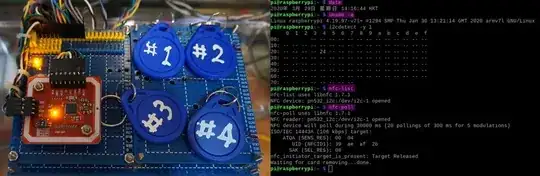

I am using the RFID/NFC module already tested OK using libnfc-1.7.1 in I2C configuration (Appendix A).

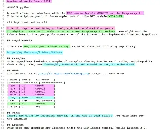

I read MFRC522-python/mfrc522/SimpleMFRC522.py/ - GitHu 2019mar26 saying the following:
@death-droid Improve compatibility with Python 3 - 2019mar26
So I guess the earlier versions of SimpleMFRC522 were not very compatible to python3. I was wondering if my pip3 installed stuff is more or less updated than the OP's corresponding software using Git Clone. I guess I better download the most updated versions of mfrc522, SimpleMFRC522, and the demo/test red/write tag programs and freeze them for later testing.

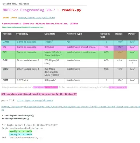

Now I have tried the SPI loopback test and found it OK. (Appendix E)
I tried to repeat the OP is problem, ie, raed a tag. Still no luck, the program hanged. Because I already double checked that the NFC module can read OK the same tag using libbnfc-1.7.1 I2C mode, and SPI loopback at 50kHz is OK. So the problem is likely at the SimpleMFRC522 side. Next step is to debug Read.py, SimpleMFRC522.py and the MFRC522.py library. (Appendix J)
