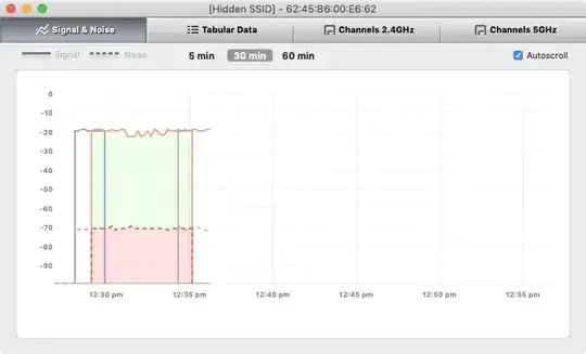

Edit 1: Screenshot of Netspot's network list, after running the networks for 7 minutes
Screenshot of Netspot's network list, after running the networks for 7 minutes. The greyed out networks are no longer detected.
Signal to Noise ratio graph
So I was slightly wrong, the first "network" BSSID stays up for 60 seconds after the second one appears, and then shuts down, like clockwork.
This is synced with the time, interestingly. Here I started hostapd at 12:17, the second BSSID appears at 12:29, and the first disappears at 12:30. For a sanity check, I waited through 12:35, and put a clock up with seconds just to check. At exactly 12:34, BSSID 3 appears, and at exactly 12:35 BSSID 2 disappears.
