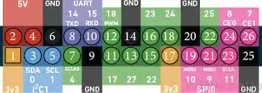

First a complete picture with "official" colored wires. enter image description here Thanks to fiery for providing this picture to connect an USB to TTL serial adapter.
As shown in the pinout you have mixed up TXD (pin 8) and RXD (pin 10). Maybe it is the reason why your adapter get hot?
pinout

    I don't think he's got the pins mixed up TXD on the USB serial cable goes to RXD on the pi and vice versa. – justinjt Feb 26 '20 at 21:12
    @justinjt If you see it from that side you may be right... – Ingo Feb 26 '20 at 21:35
  • @justinjt If the pins were swapped, I'd at least see some garbage. But here, I don't see anything. I'll try your method right now and see how far I go. – Unmanned Player Feb 27 '20 at 05:42
  • @justinjt kernel: [174467.510879] ftdi_sio ttyUSB0: usb_serial_generic_read_bulk_callback - urb stopped: -32 This happened. I swapped them to the order as show in your image and I saw a ? on screen and syslog reported this. I call as picocom /dev/ttyUSB0 -b 115200 -r -l. – Unmanned Player Feb 27 '20 at 05:52
  • @UnmannedPlayer I said I don't think you have the pins swapped. The way you have it in the original picture is correct. RPI TXD -> usbserial RXD, usbserial TXD -> RPI RXD – justinjt Feb 27 '20 at 08:13
