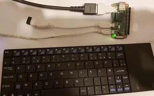

ROUND 3 :
  • I did a full format of my 16gb sandisk with https://www.sdcard.org/downloads/formatter/
  • I burned the image 2019-09-26-raspbian-buster.img with https://www.balena.io/etcher/ (I usually use Win32DiskImager-odroid-v1.3, that supposably double checks each writing cycle, never had any problem with it)
  • did not do any update/upgrade, just first boot setup, checked the ip, usual 192.168.1.51
  • tried to ping the router and...it does not work...
my setup can't be more simple than this
I'd be tempted to think I killed the wifi ship soldering the header, but I get an IP,
  • just installed a terminal on my android phone, I can ping the router....
(next step : I am getting a wizard and maybe an exorcist too...)

  • Please identify the MAC address of your wireless adapter. I added the statement "PER THE COMMUNITY'S FEEDBACK THE STATIC IP WAS CHANGED TO DHCP" above the screenshot. Only you can ensure that it is position correctly. Test results above the statement would be STATIC IP related and test results below the statement would be DHCP related. Now that you are using DHCP: when testing the wireless, be sure that the ethernet is disconnected when DHCP assigns IP address (boot time). Best to reboot with ethernet disconnected, then test wireless. – gatorback Feb 15 '20 at 15:25
  • Have you tried connecting the Pi to a TV to setup and test the wifi from the Raspbian GUI? This is an easy fast & fast test: especially coming from a fresh Raspbian flash of the SD card. https://www.raspberrypi.org/documentation/configuration/wireless/desktop.md – gatorback Feb 15 '20 at 15:30
  • I did put down the wlan0 and brought it back up, I tried rebooting too, dhcp works fine, still cannot pigng the router, I never encountered such a case – phil Feb 15 '20 at 15:57
  • I either use an ethernet dongle to debug it or I plug it to a pc hdmi screen – phil Feb 15 '20 at 15:57
  • I strongly, strongly suggest removing the ethernet dongle, reboot and test \ debug from a Raspbian console (connect HDMI and USB keyboard). I have edited my Answer this morning and would be interested in the test results. My hunch is that your hardware is good and that the problem lies on the SD card – gatorback Feb 15 '20 at 16:01

I recommend trying to verify hardware is working: DHCP requires communication between the wifi adapter and the router, otherwise it can not be assigned an IP address. If you can confirm the wifi's MAC address was received by the router, then the wifi's transmit side is working.
If you had a second Zero-W with functional wifi, you could transfer the SD card and expect it to work in the system under evaluation.
My experience tells me that you would be better off to:
  1. Disconnect the ethernet dongle from the Zero-W
  2. Flash a different Raspbian version to a new/different SD card and install SD-Card
  3. Connect the Zero-W to a keyboard and monitor THEN
  4. Configure wifi from the Raspbian GUI per instructions:
  5. Identify & Test DHCP issued address
    • ping gateway from rPi
    • nslookup yahoo.com's IP address and ping that number from rPi
    • ping rPi's IP address from another LAN connected PC
  6. Post the current (Ampere) rating of your 5V power source and compare it to the requirement
