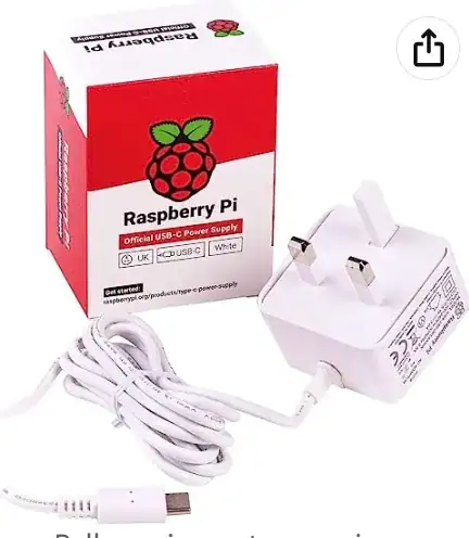

I have actually experienced this myself. I had loud clicking/chirping noises from a Toshiba Canvio 1TB and a WD Elements 2TB drive when both were plugged into an Rpi 4 at the same time. Also file system corruption. However, with the WD 2TB USB powered drive, and a Seagate Backup Plus 3TB drive with its own AC power adapter, everything works fine. Each is connected to one of the Pi's USB-3 ports and they form the storage for a NAS and are formatted ext4 as using NTFS brings speed problems on Linux systems.
Note: as advised by the Raspberry Pi Foundation, I use an Official Raspberry Pi 4 Power Supply. Not using one has been shown to be the cause of intermittent problems or issues of many kinds.
