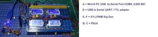

(2) Using Win10 RealTerm terminal emulator to serial/UART talk to XY-LPWM
I am now using Win10 RealTerm terminal emulator to talk to XY-LPWM. The serial parameter setting is the following:
9600, N81 (9,600 baud, No parity, 8 data bits, 1 stop bit)
(a) I first did the RealTerm loop back, shorting TxD to RxD, and make sure any characters typed at the keyboard or send by RealTerm will be looped back / echoed at the RealTerm screen.
realterm wiring
(b) Then I connected Win10 RealTerm USB to serial adapter/cable to the XY-LPWM sig gen as show below:
Win10 USB Serial   XY-LPWM
TxD                 RxD
RxD                 TxD
Gnd                 Gnd
Then I send commands
(1) "F010 to To set frequency 101Hz,
(2) "read" to read back "F010", "D050" confirming everything OK.
The two commands and response are displayed below:

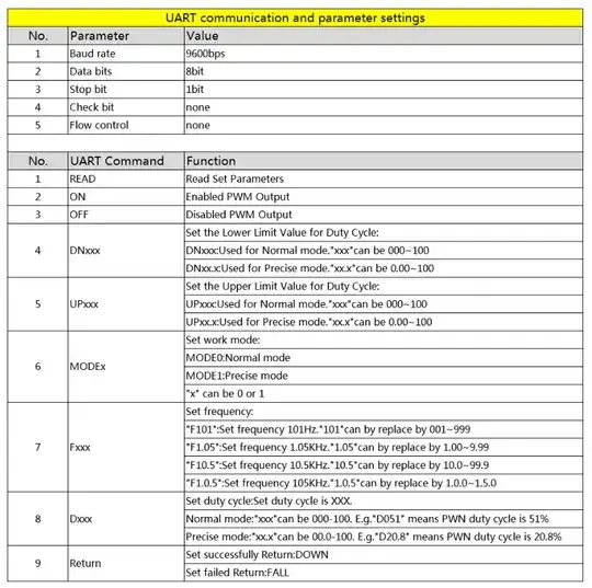

Appendix C- XY-KPWM Sig Gen Spec and UART user guide
AliExpress (UART support) XY-KPWM Signal generator 1 channel 1Hz-150KHz PWM pulse frequency duty cycle module adjustable LCD display - US$3.6
Features:
  1. UART support
  2. Frequency range (Normal mode): 1Hz ~ 150KHz;
  3. Frequency range (precise mode): 1Hz ~ 15 KHz;
  4. Frequency accuracy: 2%;
  5. Accuracy of the duty cycle: 1% in Normal mode;
  6. Accuracy of the duty cycle: 0.1% in accurate mode;
  7. Service cycle range: 0.00% -100%;
  8. Output current: approximately 5-30mA;
  9. output amplitude: identical to the input voltage;
XY-KPWM UART User Guide
xy kpwm uart
