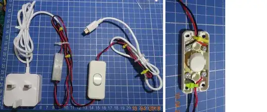

  • This is the switch you can DIY: https://imgur.com/a/7GcpXDI. – tlfong01 Oct 03 '19 at 06:29
  • @Milliways sorry I updated my question with fan link – Juliatzin del Toro Oct 03 '19 at 07:03
  • And you can use this kind of switches: https://imgur.com/gallery/R0j5Ac9. These are 250V AC 3A ~ 5A switches. Your Rpi4 5.1V ~ 5.3V DC 3A wall wart output has a micro USB connector. So I would suggest (no guarantee nothing won't melt down!) to "insert" the switch between wall wart and micro USB connector. – tlfong01 Oct 03 '19 at 07:18
  • Now the time has come for the cut operation. First thing first is to cut the wall wart to micro USB connector power cord into two halves (sorry, unplug the wall wart first!). And before the cut, you need to think twice that if the two "halves" are really halves, or one long half and one short half, say, one quarter and three quarters. Now you strip the ground wire and 5V wire, IN DIFFERENT LENGTHS. This important for newbies, who always short the red wire with the blue wire and cause explosion. If red is shorter than blue, then the newbie can live longer: https://imgur.com/K2UOQGj – tlfong01 Oct 03 '19 at 07:58

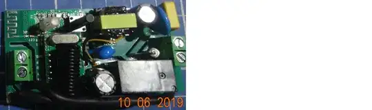

sonoff_2019oct0601
sonoff_2019oct0602
sonoff 2019oct0602
For those those are interested to learn about Sonoff, IoT MQTT, ESP8266 etc, and dare not to touch the dangerous 200VAC mains, you can consider doing the following experiments.
(1) Open the Sonoff cover (it is hacker friendly, takes your less than 3 seconds)
(2) Study the schematic, find where the AC200V to 3V3 transformer output, remove the AC circuit, supply your own 3V3 power. Update (Ref 22 Youtube has a very good description of how NOT removing AC to DC converter circuit and can just supply your own 3V power from Win10 USB to UART TTL.)
(3) Find the ESP8266 chip's TxD, RxD, GPIO pins and use Rpi ESP8266 IDE to program the ESP8266.
There is a tutorial (Ref 20) on how to use LUA to program the ESP8266/ Sonoff smart switch. This tutorial is simple because it does not make use of any cloud, third party server, MQTT broker, you just use your smart phone to WiFi talk to ESP8266 whose pins can do the following: (1) switch on/off Rpi (logic or power circuit), (2) switch on/off cooling fan, with the help of ddriver 2N2222.
WARNING: I myself have not tried it. So there is no guarantee that something won't explode!
/ to continue, ...

Appendix A - Power Switch DIY Notes 1 - Cutting power cord to insert switch
stripping wires
Appendix B - Power Switch DIY Notes 2 - Switch inserted
pss switch
Appendix C - Rpi4B + PSU - Power Switch Testing OK
system testing ok
