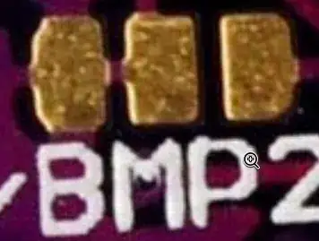

There is no physical switch on the PCB, instead, there is a solder jumper consisting of the three pads in a row next to the sensor:
The center pad is connected to the SDO pin of the sensor, the upper left to GND, and the lower right to 3.3V.
By default, the center pad should be connected to the upper left pad, but you need it to be connected to the lower right one instead! (But only for ONE of your two sensors). This simply needs a soldering iron and a little solder.
Now, there should be a blob of solder connecting the center and upper left pad, similar as on the left side on this picture:
I do not see this blob on the picture of your PCB, may be, your real PCBs have them, maybe, not.
If not, the two pads are for sure connected by a thin copper track, as on the right side in the image from me above. If this is the case, this thin copper track must be removed with a sharp knife. I don't see such track on the photo of your PCB. It might be covered with the violet paint, so you should carefully check it.
(FYI: The reason for the small copper track is that the blob needs lots of solder, while industrial soldering processes use very little solder. So, such blobs need to be placed by hand. To avoid this, that small copper tracks are used, so the few people which ever want to modify something here, would need to cut that track, first.)
As you uploaded a high resolution image of the PCB:
It is exactly what I wrote. There is a track between the central and the left pad, covered with violet solder mask.
- Remove the track between the pads with a sharp knife.
 - Connect central pad with right pad with some solder.

Update: in newer version of BME 280 chip, the track connecting the left and center pads is not between them, but goes up directly to the chip, as you can see in this photo. I succesfully changed the address to 0x77 by cutting that track and connecting the right and central pads.
