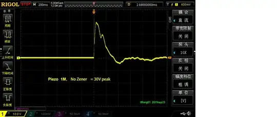

(A) Piezo with 1M, no Zener, One slight finger tap gives 30V peak
I was curious to know how high would be the piezo output voltage, without clamping it with a Zener diode. I surprisingly found it as high as 30V! This would fry both the MCP3008 and and it master Rpi!
Conclusion: Zener diode is absolutely necessary!
