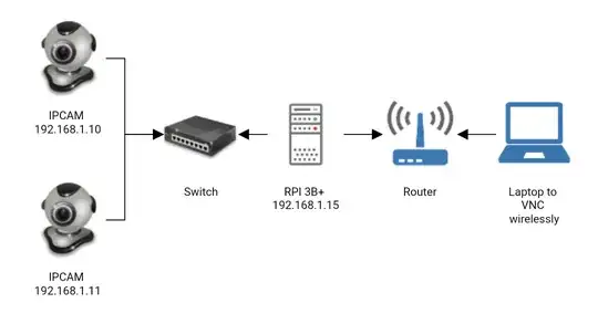

I would like to connect 2 ipcams via a switch to the RPI 3B+, and use the WiFi to connect to a router (to use the webbrowser etc), and also use the router for VNC
The ethernet is used to send commands to the camera and also watch the streams.
What is the best way to make this possible ?
Can I use the ethernet and WiFi at the same time ? Or do I need to set the switch to 192.168.2.xxx and the WiFi network at 192.168.1.xxx
Or do I need a separate DHCP server ?
Networking image

  • Is it also possible to completely block the ethernet side to the wireless side ; "internet" ? I would not like the cameras to access the local WiFi network – Jeroen_13 Aug 25 '19 at 16:51
  • @Jeroen_13 Yes it is possible by using firewall iptables or policy routing. How do you want to send commands to the camera and also watch the streams? Only from the INTERNET and from devices connected to the switch? – Ingo Aug 25 '19 at 17:33
  • I would like to use the raspberry PI with node.js to send commands to the camera's, use VLC on the PI to watch the streams, and use the laptop with VNC to do stuff on the PI, so I don't need a monitor. The PI just acts as a controller for the camera's, and I want to use the WiFi for VNC monitoring. That's why I don't want the camera's to access the rest of the network (including a NAS) – Jeroen_13 Aug 25 '19 at 17:43
  • @Jeroen_13 OK, running things only from the RasPi makes it easy. Just deleting the line IPForward=yes in /etc/systemd/network/04-eth0.network should do the job. – Ingo Aug 25 '19 at 17:48
