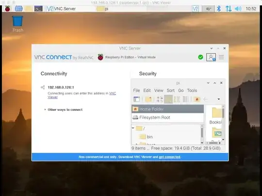

Your pi seems not running a graphical desktop. Since remote access with SSH is working, an alternative solution is to create a virtual desktop using the VNC Server and connect to it afterwards.
The raspberrypi.org provides a doc for such connection: with SSH, run vncserver and make note of the IP address/display number. Then you can use it for the VNC connection.
With my headless pi as an example:enter image description here
The IP address/display number for the VNC connection is in the Connectivity section. BTW I hide the Security information.
