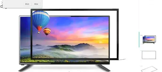

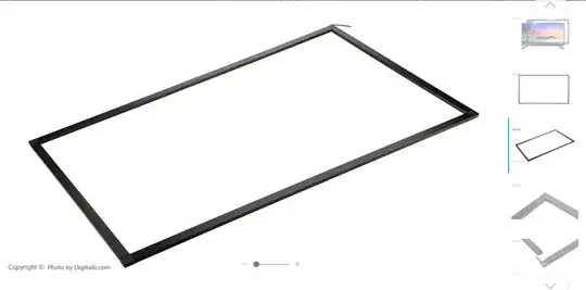

I need to use one touch panel for my LCD monitor 32 inch, so i found this kind of NOVA USB touch panel :
enter image description here enter image description here
in the description it said it is working with Linux OS and working without needing to any software!!!.

The panel looks like an IR frame.
There is no touch surface.
There is a matrix of IR beams that detect a touch when something interrupts the beam.
It is probably seen as an ordinary mouse, so it requires no driver.
Such a device usually does not support multi-touch.

  • So is this device works with raspberry?I don't find any datasheet for it, base of what i could write the source code for analysing its output data's in raspberry? – Soheil Paper Jul 03 '19 at 08:02
  • i know nothing about the device ... i was only making an observation ... the possibility is strong that it is seen as a mouse ... if it is seen as a mouse, then it should work .... ask the seller to confirm its operation – jsotola Jul 03 '19 at 19:32
