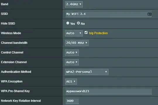

My WiFi settings:
When I plug the SD card back into the PC again, the files are missing (I assume it does its magic and applies the settings, then removes the files afterwards). However, when I look at the monitor, it shows SSH has been enabled, so I know that works.
